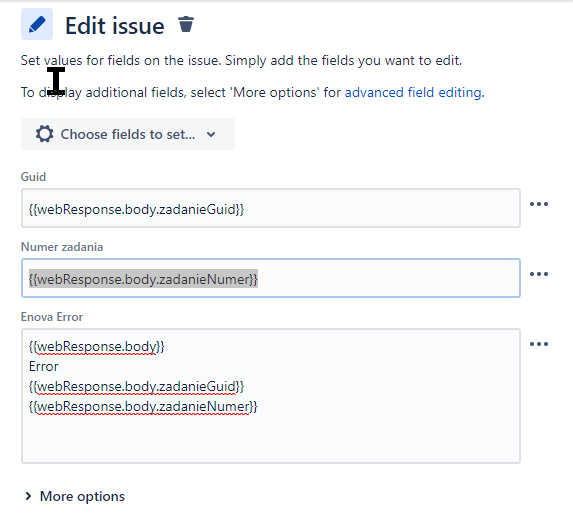

In my automation rule I use send web request component. It returns me for example this json in {{webResponse.body}}:
{"zadanieNumer":"ZGL/2022/02/11","zadanieGuid":"dcc40184-e41c-4d70-97a9-053f6039b4cc"}
In next step i use Edit issue component to set value to custom field.
When I set field with value: {{webResponse.body.zadanieGuid}} i get empty value.
The same with {{webResponse.body.zadanieNumer}}. It should be possible to get value this way. Can somebody write mi what I am doing wrong?
I added screen with my Edit Issue component.

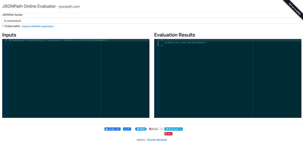

Hi @Grzegorz Ostrowski ,
I went ahead and tested your smart value and it's valid so there's no issues there.
Could you confirm that you have the setting in the image below set?
Json Tester --> https://jsonpath.com/

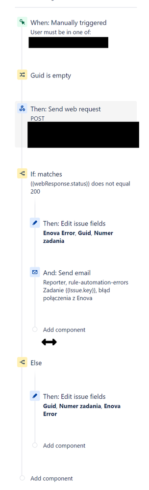

If possible could you please share a screenshot of your entire automation rule, hard to tell that one of the many factors that could be effecting this aren't present.
Grzegorz Ostrowski
February 10, 2022
@Mark Davidson This is schemat of my automation rule:

@Mark Davidson  I have managed using this code in Edit Issue component to get values from JSON {"zadanieNumer":"ZGL/2022/02/11","zadanieGuid":"dcc40184-e41c-4d70-97a9-053f6039b4cc"}.
But it should be as simple as {{webResponse.body.zadanieGuid}}. Why it dont work in my case. Is this some kind of bug?
