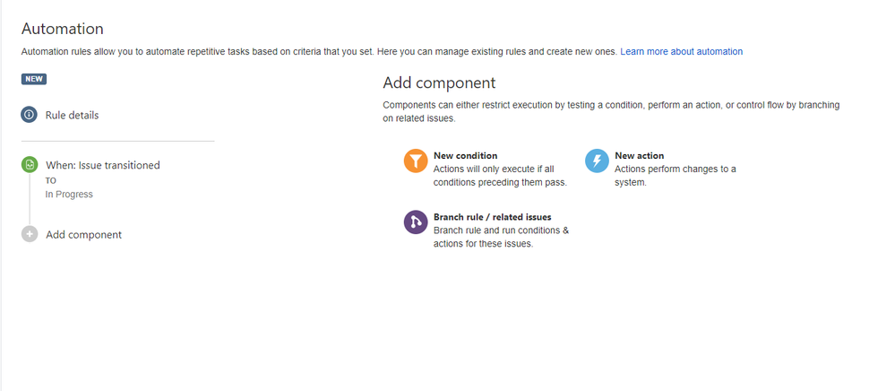

AB September 17, 2024
I am still learning and very new to JSM config, so my apologies in advance for any dumb question. I don't know why but I have two different screens for automation in QA environment and Prod. I am enclosing screenshots for reference. And Yes, It is data center. prod.png QA env.png

Everybody is new to Jira at some point. 😉
In Data Center, Jira Service Management had its own Automation feature. That is what your first image shows. With later versions an Automation feature that works with both Jira Software and Jira Service Management was introduced. That is what your second image shows.
You can find documentation for that second one here:
https://confluence.atlassian.com/automation/
The Schedule trigger will be available in the second Automation feature.
