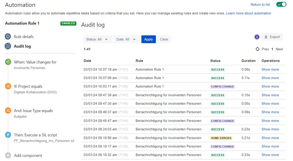

  1. Automation Rule 1: When new users are added to Field A (called involvierte Personen), only the newly added users (excluding those who were already there) should be added to Field B (called Benachrichtigungsfeld). I've set this up using SIL, and it's working well.

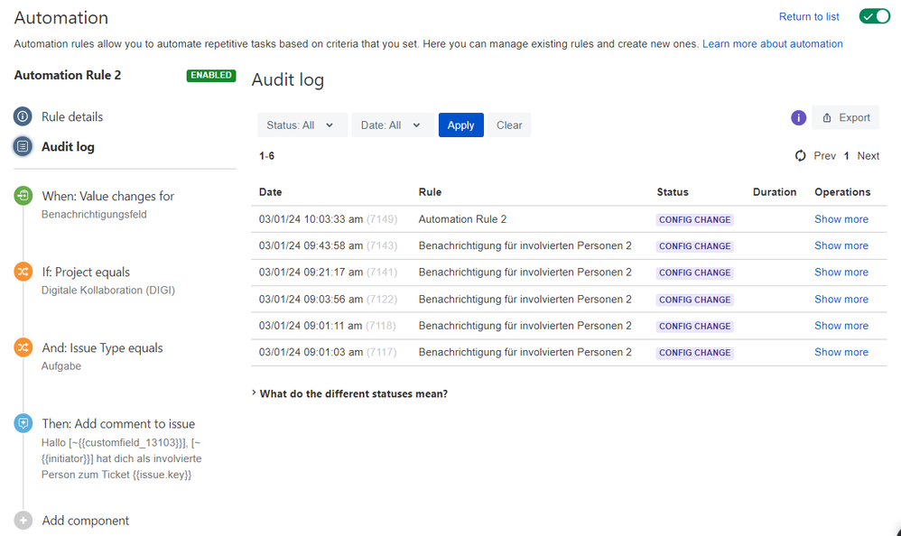

  2. Automation Rule 2: If the value of Field B changes, a comment should be posted, mentioning the new users that they've been added to Field A. However, this second rule doesn't execute, even though I've enabled the option "Check to allow other rule actions to trigger this rule" in Automation Rule 1.
The audit log for Automation Rule 2 shows no errors; it's as if nothing has triggered.

If so, be sure that that box is definitely checked and you have published it as such. Can you share a screenshot of that?
Amin January 4, 2024
Hi John,
Thank you!
The value for Field B is getting updated by automation rule 1, but automation rule 2 doesn't get executed.
I've just tried changing the value for Field B manually and automation rule 2 got fired.
It seems the problem is that the autoamtion rule 1 cannot fire automation rule 2, although it changes the value for Field B.
Please find the screenshot below.
