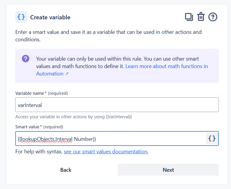

While your solution works I'm blocked because of this bug: [JSDCLOUD-12831] Automation smart value math functions do not work on the Assets object and field Integer attributes - Create and track feature requests for Atlassian products.
{{#varLoopValues.rightPad(varLoopValues.length.plus(varDateDiff), "X").remove("NULL").replaceAll("X","X,").substringBeforeLast(",").split(",")}}{{#=}}{{index}} * {{varInterval.asNumber}}{{/}}{{^last}},{{/}}{{/}}
varInterval is a variable that I created in the automation rule (screenshot) following the workaround from the bug. But for some reason it does not work.
It fails with
Unable to render smart values when executing this rule:
Unknown unary operator * at character position 1: *
I even tried with {{index.multiply(varInternal.asNumber)}}.
For some reason automation rules can not process variables coming from an assets object.
On the other hand, this woks within a Log action:
{{#=}}{{varInterval}} * 15{{/}}
Like • Bill Sheboy likes this
