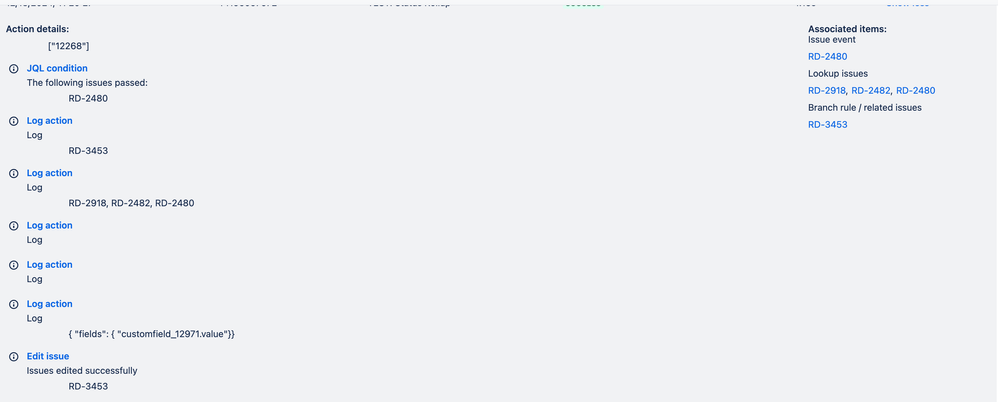

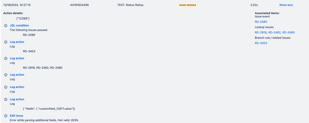

Please show images of your current Edit Issue Fields action and of the audit log showing thee rule execution.

@Bill Sheboy Here is the info youre looking for!
Screen Shot 2024-12-18 at 10.48.51 AM.png Screen Shot 2024-12-18 at 10.49.09 AM.png
December 18, 2024 edited
Sorry, as I had a typo missing the closing quotation mark around the "fields" element.  Please add that and re-test.

@Bill Sheboy it looks like it ran "successfully" so were getting closer. But the results didnt get added to the field.
Screen Shot 2024-12-18 at 11.25.18 AM.png Screen Shot 2024-12-18 at 11.25.35 AM.png
December 18, 2024
Based on that log entry, there is something wrong with either your created variable or the edit.
The audit log entry showing what you tried for the JSON is incorrectly, so update it to exactly match what you are using in the edit issue action.
