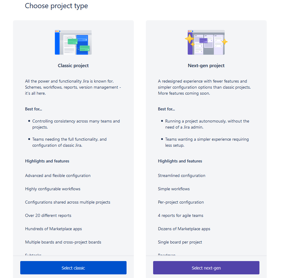

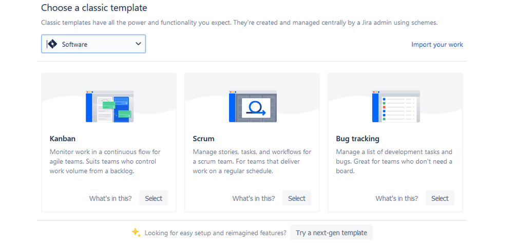

When we start a new project - after some insuccessful testing/usage of the next-gen projects (as you might remember) - we always start with "classic project".
The next step is to click on "change template" (or re-use the prviously chosen project - don't know why it's suggesting a Kanban board here, since we never used one).
Then we either choose the classic (that was the classic I was referring to) template "Project Management" in the "Business" section (using the scheme of a default project we built), or we go to the "Software" section and choose a "Scrum" project there (again, with a preconfigured default project as template).

If I understand you correctly, you are referring to the classic template "Project Management" of the "Business" sections - but using this template, I can't make ANY changes regarding the board.
Or did I misunderstand you at a certain point?
Thanks (again and again) for your help and for any further suggestions,
Sebastian
