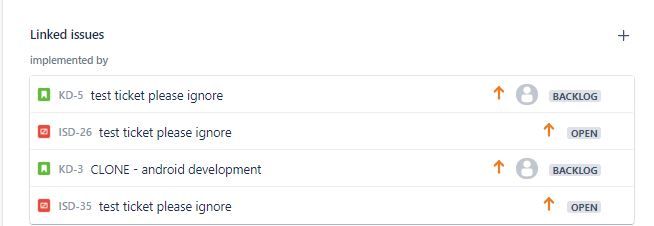

@John Funk  it dodnt work for me
i want to update my "test custom field" with the issue key of issues linked under " implemnedted by "
KID-5, ISD-26, KD-3, ISD-35
How can i do that ?

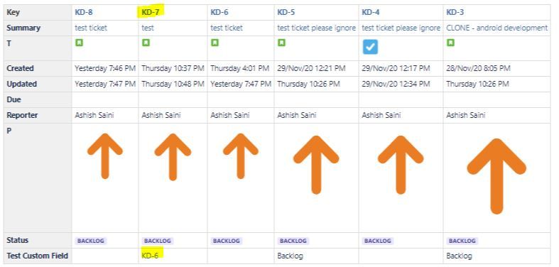

I basicaly wanted to update my est custom field with issues keys of issues linked by "implemenetd by "
KD-8 has a linked issue KD-6 , but the custom field is not updated by the issues key KD-6
What is missing in this ?
Can you please advice.

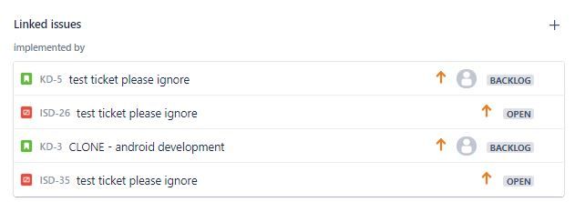

Ashish December 18, 2020
@Bill Sheboy :  Basically we are trying to automate our confluence , a table is created which needs to be update the values of linked issues " implemented by " every time new issues are
PFA screenahot , how i can get the linked issue in KD-6 with relation "implemented by "
Capture.JPG inked .
So , this is the purpose of automation.

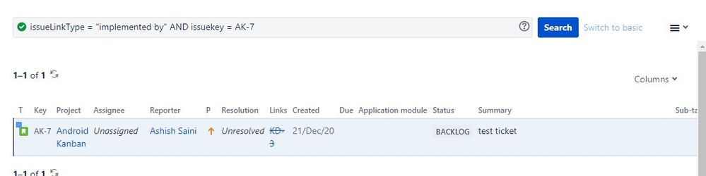

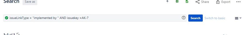

December 28, 2020
I believe the links are case-sensitive.  Please try the exact spelling and capitalization of your link to learn what that returns.
Ashish December 29, 2020
@Bill Sheboy First of all ..Merry Xmas and happy new year.
Does this help ?
December 29, 2020
Hi @Ashish   Happy holidays to you as well!
Did you notice that your link has a trailing space in "implemented by " when it works with JQL and does not have the space in your other attempt.  Please check to see if there is a space in the actual name of the link as that could be why it doesn't return anything in the rule.
